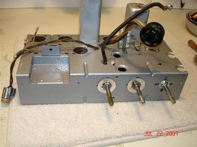

1/23/2012 11:15:56 PMDennis Wess
Here's a photo of a chassis that was spray painted with Rustoleum "Hammered Finish".....all rubber cement and painter's tape masking was removed just prior to the photo being taken.
1/23/2012 11:21:01 PMDennis Wess
It should be noted that I only paint a chassis if it is in horrible shape due to heavy rust / corrosion / discoloration. The majority of the time, Naval Jelly will be sufficient remove grime, light rust and corrosion and will leave the metal looking clean and bright.
