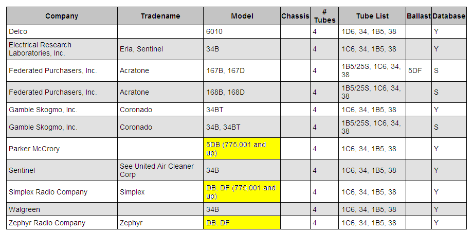

Sir AJ. . . . .
Try these on for size . . . and see if there is a fit . . . some of these have similar serial numbers.
The yellow highlighted ones seem to be in accordance with your serial and DF aspects.

The escutcheon of your radio does look like a Simplex. It is upside down. The Simplex name would have been on the bottom of the escutcheon.
