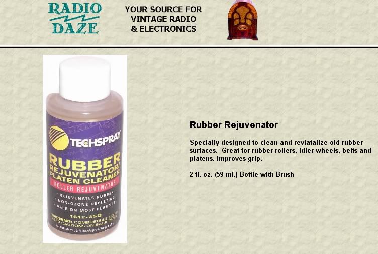

1/30/2011 7:48:10 AMDennis Wess
This stuff is available from www.radiodaze.com
