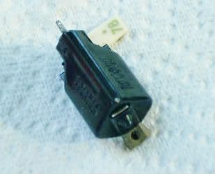

:Hi! Warren,
I finally got a picture to up load. This is a picture of the cartridge that I'm asking if it is a crystal one. I have 3 of these, with 2 only putting out faint sound. Are you saying to put a preamp on one of these to see what kind of volume I get?
Bob Masse
10/25/2010 12:49:57 PMWarren
That does look like an old ceramic type. Forget using a preamp with that. You can ether replace it with another ceramic. Or go with a good magnetic cartridge and the preamp.
