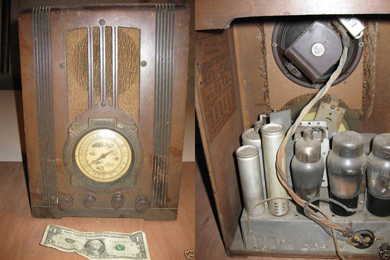

Do any of you guys know the corrct model of this radio and where I might be able to find the schematic?
It is supposed to bean "Arrow"
It looks very similar to the 30A Arrow on www.radioattic.com

Could this be the Sentinel 30A?
Is one of the tubes a 6D6?

I am pretty sure I have identified your radio because I found a picture of the Sentinel Model 30A from the rear:
http://www.antiqueradios.com/gallery/v/Sentinel/1937_Sentinel_30A_Rear.jpg.html

Dave... that sure looks like it's right.
