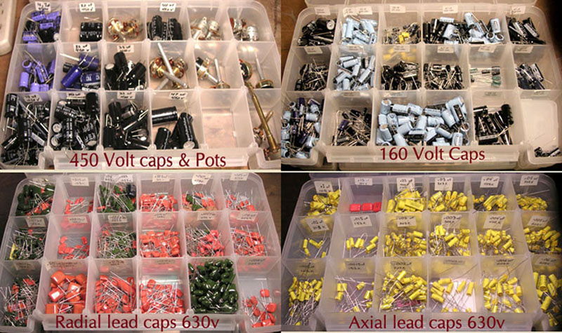

Hi Tim:
I got tired of trying to order a couple of this and a few of that.
... so I treated myself and bought a good reasonable stash of parts that I'll most likely need for ALL radios from 1930 to 1949 that I restore most often and enjoy.
It didn't really cost that much ... and after all, it's a GIFT to myself!
... one I enjoy everyday now in my retirement. So I deserve it.
Then I had to come up with a nice simple storage arrangement to keep the lower voltage caps separate from the high voltage ones etc.
Here's what I came up with:

I have a similar - though less extensive - setup to Peter's. Some form of this stock and organization will be rewarded with fewer head aches. Break or clip a cap lead too short? If you've ordered only one.....you'll scream like Howard Dean!!!!
