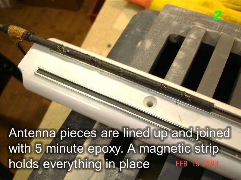

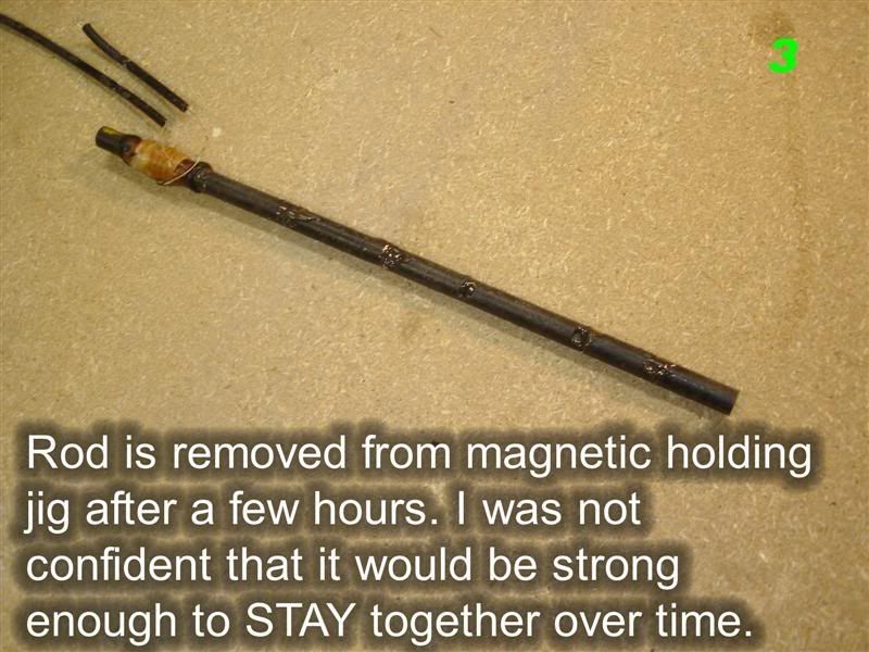

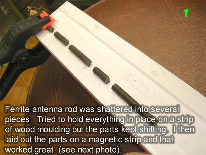

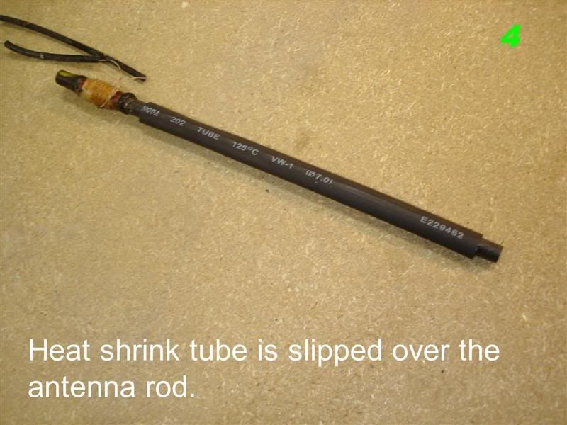

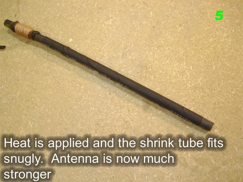

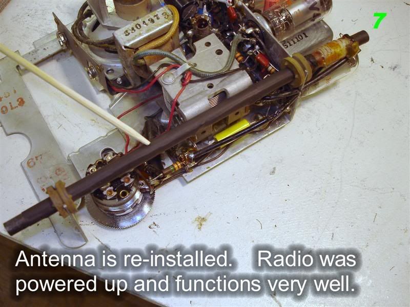

Here's a fix I recently used on a rod that was broken into several pieces. It works fine now.
Dennis
Try to apply the epoxy only on the peripheral surfaces of the rod......not "in between" each joint. Simply butt all pieces together snugly then apply the epoxy with a toothpick......don't use too much epoxy.
12/12/2009 9:09:45 AMDennis Wess
Forgot to mention.....JB Weld (The 5 minute type) would work just as well as any good epoxy. As a matter of fact, JB Weld is my preferred adhesive to use around the shop. Good Stuff. I don't use the "overnight" type of JB because it seems to take forever to cure.
12/12/2009 11:05:14 AMGary W. Prutchick
Dennis,
Fantastic job!
I suppose you could use a conductive adhesive at the joints. The heatshrink is a good idea, it not only adds some strength to the repair it also cleans it up. Looks great!
