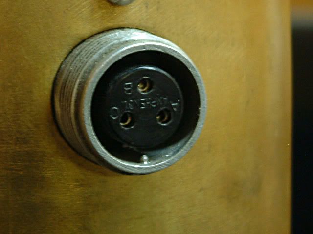

Hi All,
I am trying to identify the following connector/jack, which is on a DAE-1 loop antenna mast. The threaded outer part of the connector is 7/8" in diameter, and the three prong holes are labelled 'A', 'B', 'C'. When I find out what the official designation for this connector type is I can then: i) Google the designation to get more information ii) try to find either the connectors and/or the right cable on ebay.
Here is the picture (hopefully). Fingers crossed.
DAE1_Loop_Mast_Antenna_Jack
10/26/2009 8:28:32 PMWarren
It looks like an old Amphenol connector. Used by a lot of military equipment. Discontinued though.
10/26/2009 8:30:31 PMEdd
Sir Leslie. . . .
Try this on for size:
http://www.amphenol-aerospace.com/new/pdf/12-022-15_97Series.pdf
