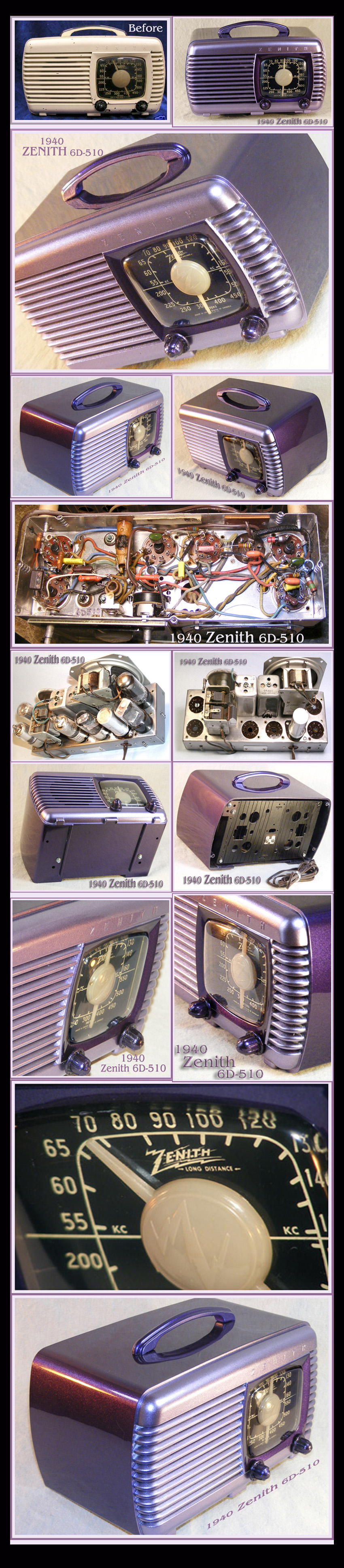

Here's my latest Zenith restoration.
It's a 1940 Zenith model 6D-510 that I bought on Ebay three years ago for $34.00 including shipping..lol
This is the set I was talking about in my post the other day about having mis-wired the grid bias resistor on the output tube creating garbled audio. It is a wonderful performer now however!
I took particular care to dress all the new components and wiring under the chassis.
This particular metal chassis was not in very bad shape as far as rust goes but it did require some serious cleaning as it was rather "gunky".
After removing the speaker and tuning condenser.. I used some GoJo brand hand-cleaner w/pumice on the chassis top and bottom....and scrubbed it all around w/a 1/2 inch wide long-handled, stiff short-hair artist's brush so as to be able to easily get into all the tight corners and crevices.
Then I also used a green 3m scrubbing pad. Afterward I dunked the tuning condenser and the entire chassis in hot soapy dishwater in the kitchen sink and rinsed it off with the sink hose.
It came out gleaming. Arterward I then placed it in the warm but shut-off oven overnight.
Back on the bench the next day, I reinstalled the tuning condenser with all new rubber grommets and then re-strung the dial string too.
Then off to the garage where I sprayed the entire chassis with clear gloss lacquer both top and bottom to seal it from rust. Then I sprayed the loop antenna too with flat black paint.
I'm very satisfied the chassis now, as it is at least as good as NEW.. maybe even a little better...lol
As far as the choice of paint on the cabinet I decided to go with clear-coated complimenting shades of purple throughout.
The main body was done in bold-metallic-purple and the front face and grille-work was done using a shimmering icy-metallic-violet.
The top handle and tuning knobs as well as the frame around the dial face were all done in the darker purple for a balance of contrasts.
I had to re-polish the dial-lens with Brasso to bring it back to life... I really cleaned it up bright.. yet it still retains a bit of an antique hue.
The dial face itself only needed washing.
I think the end result is really outstanding and speaks for itself.
How do you guys feel about it?

6/2/2009 4:08:06 PMThomas Dermody
Interesting. It looks classic, but also modern, like you could buy the radio at a store today. The paint sure is smooth. Regarding anyone's complaints on the paint scheme, remember that paint can always be changed.
Did you install a new twist-lock electrolytic or is the old one still working strong? Zenith electrolytics tend to be good often enough. Must have been good design. I don't see any modern electrolytics under the chassis, so I assume that the twist-lock is in use.

Hi Thom;
No that's the old non-used electrolytic can.. the black paper cover came off and that's what's underneath.

: Hi! Nice job!!! When you say you used Brasso to polish up the dial lense, it leaves me confused.There are many Brasso products out there.Which one do you use on dial lenses.Thanks for any info. Bob Masse
6/5/2009 7:32:06 PMPeter G. Balazsy
:: Hi! Nice job!!! When you say you used Brasso to polish up the dial lense, it leaves me confused.There are many Brasso products out there.Which one do you use on dial lenses.Thanks for any info. Bob Masse
Hi Bob:
Thanks for the nice compliments.
It's the metal polish for use on Brass.
Sometimes I'll fist soak the lens in 50/50 vinegar and water for several hours or overnight to help get the yellow out some.. then Brasso.. then also a wax or polish even.
