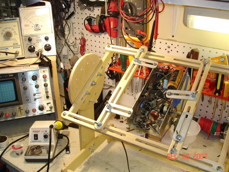

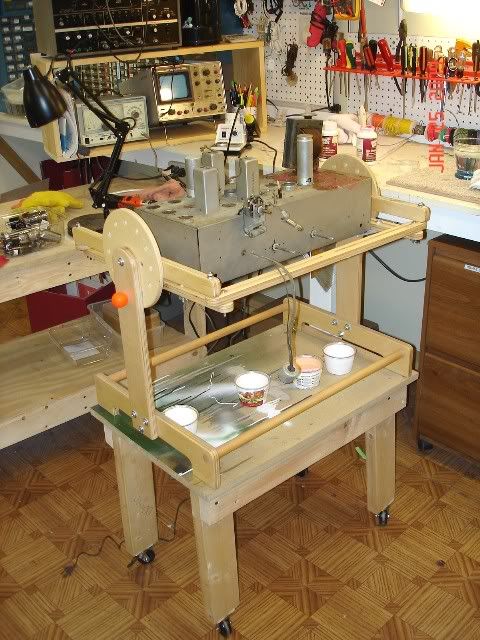

6/2/2009 8:52:56 AMDennis Wess
A few years ago I purchased two chassis stands....a small one & a large one. I use the small one on my benchtop and mounted the larger one on a cobbled-up roll-around base. These things are the handiest items in my shop.......(please excuse the shop mess)
6/2/2009 7:13:49 PMGary W. Prutchick
WOW! WOW! and WOW!
I didn't know such things existed!
Where does one find such treasures?
Gary
