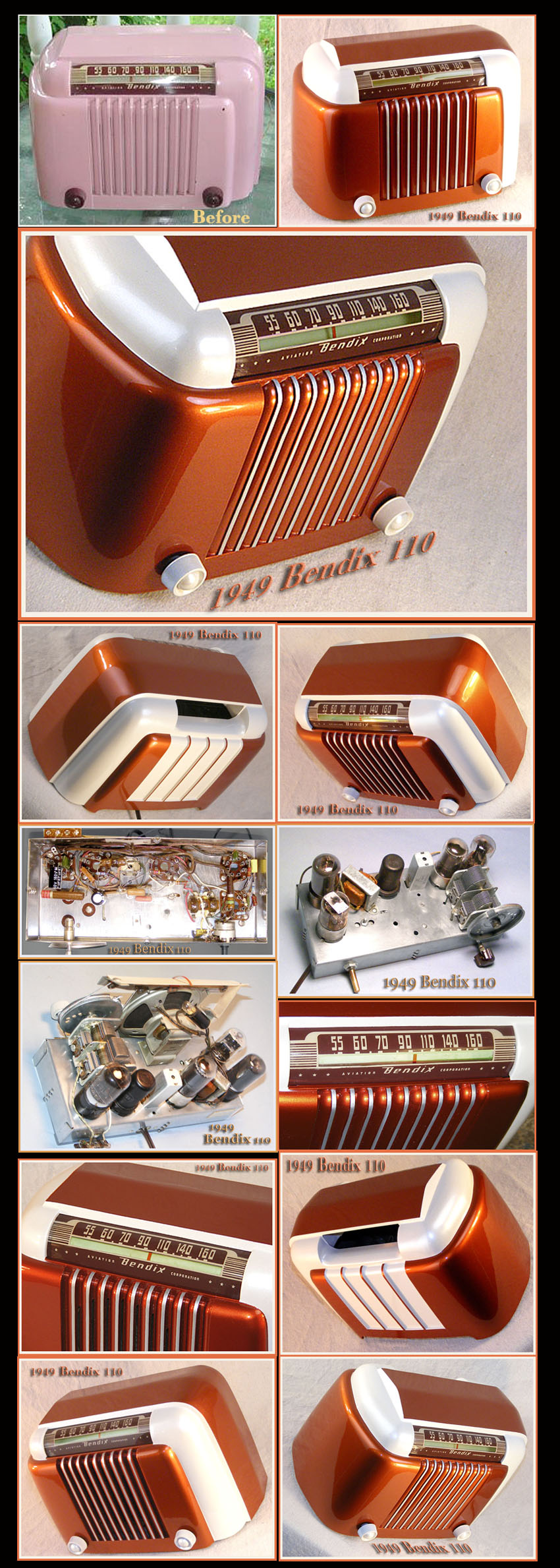

Here's my latest $47 Ebay [i]Cinderella[/i]-junker... a newly-painted Bakelite restoration. It's a 1949 Bendix model-110.
It looks beautiful ... now..yes...but they're not usually "easy" and some are tougher than others...lol
Especially this one was like giving birth...lol
The trouble I had was during chassis restoration. I usually do a quick troubleshooting fix and re-cap when I first get them in. Then as it nears the re-assembly stage, I'll dress up the electronic work then wash and polish the chassis and seal the whole thing in clear lacquer before putting it back in the cabinet.
However after I washed and dried this unit I was very tired, I guess, and when I put the tubes back in and turned it on I was only getting static.
So I thought it must still be wet somewhere and let it dry some more and went to bed.
Next day it was nicely dried alright.. still not working.. but dry.
... but no static even now.. not a peep... only the audio section seemed to work.
This unit has one pin-wheel IF transformer under the chassis and one slug-tuned mica crappy-style IF.
I was debating whether or not to tear into it anyway and tear out that mica crap before my future customer ever had to deal with it.. but up till this moment it had been working fine without those loud static bursts which are so prevalent in this style IF.
So I was trying to "troubleshoot" the non-signal problem first and couldn't figure out why it was dead.
So I started scoping around and saw that the local oscillator was dead!.. Humm why?
Don't ask..lol
I had the 12sk7 in the 12sa7 spot and visa-versa...lol
Yeah.. Me!
I even remember actually looking at those tubes too... to read the numbers.. lol
...could have sworn somebody swapped the numbers while I was sleeping.
Anyway... even after swapping-back .. it was still dead.
I could hear 455kc modulated signal loud and clear ...but only if I put it on the plate of the 12sa7..... But not if I put it on the grid!
All the voltages on the 12sa7 seemed to measure good too. ..??
To make a long story short it was a dead IF transformer... sort of.
I could force a signal in the primary and hear it all the way in the audio section fine... but that RF amp 12sa7 just could not drive it that hard...
So that was very strange.
I actually had to use my spare IF transformer to prove it to my self.. Yep.. that was it.
So then I had to tear that IF can out and rebuild it.
I decided to try to do a nice neat job of soldering all new discrete caps on the IF can lugs such that they will hang under it in the chassis. I made it look oh-so neat too!
Then when I went to put the can back in I realized that the can will not go back in with parts soldered on it !!!
So then of course ( through gritted teeth) I had to take all that careful work all apart and then put it all back on again once UNDER the chassis...lol
So my problems with this beautiful little Bendix were all self-inflicted..lol
So don't feel sorry for me!
Now to the beautiful paint job.
We used a great combo here of metallic Orange-copper with a compliment of Creamy pearlized-Vanilla.
The front grille-work was enhanced with edge-painting in brushed silver.
Note the detail of how the Copper-Orange extends carefully down the three raised rear waterfall fingers.
I think this one is a real winner.
How do you guys like it?

:All the voltages on the 12sa7 seemed to measure good too. ..??
:To make a long story short it was a dead IF transformer... sort of.
:I could force a signal in the primary and hear it all the way in the audio section fine... but that RF amp 12sa7 just could not drive it that hard...
:So that was very strange.
:I actually had to use my spare IF transformer to prove it to my self.. Yep.. that was it.
:So then I had to tear that IF can out and rebuild it.
:I decided to try to do a nice neat job of soldering all new discrete caps on the IF can lugs such that they will hang under it in the chassis. I made it look oh-so neat too!
:Then when I went to put the can back in I realized that the can will not go back in with parts soldered on it !!!
:So then of course ( through gritted teeth) I had to take all that careful work all apart and then put it all back on again once UNDER the chassis...lol
:So my problems with this beautiful little Bendix were all self-inflicted..lol
:So don't feel sorry for me!
:Now to the beautiful paint job.
:We used a great combo here of metallic Orange-copper with a compliment of Creamy pearlized-Vanilla.
:The front grille-work was enhanced with edge-painting in brushed silver.
:Note the detail of how the Copper-Orange extends carefully down the three raised rear waterfall fingers.
