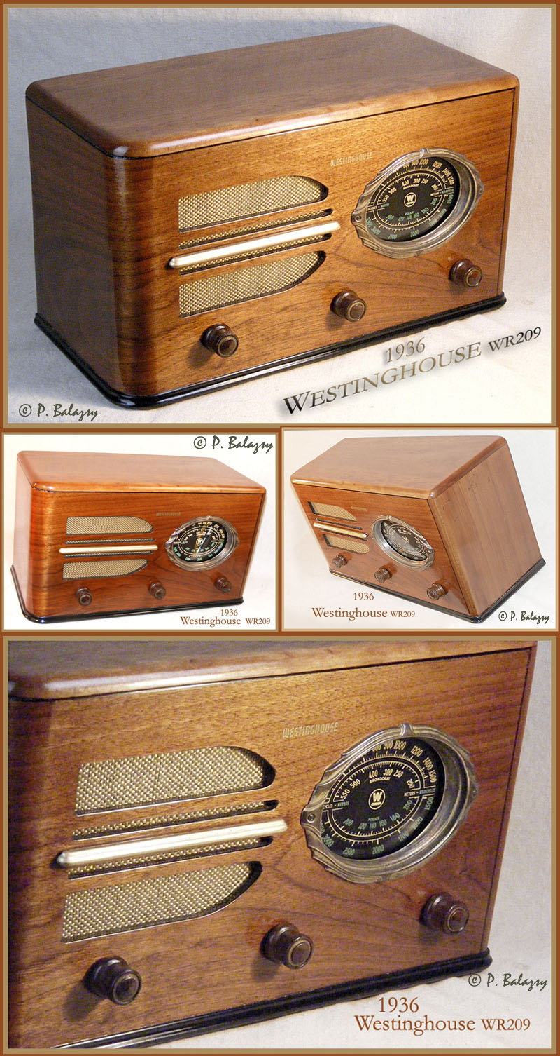

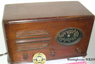

I've just finished fully restoring this solid, beautiful 1936 Westinghouse WR209.
Now...I normally use Deft spray lacquer for refinishing.. (and I truly love it) but I was tired of getting over-spray lacquer all over my nice garage floor and everything else...
So someone at ARF suggested using Alkyd Varnish and brush it on.
http://doitbest.com/Varnishes+and+shellacs-Do+it+Best+Paint-model-W54V00707-14-doitbest-sku-781602.dib
It's not as hard as polyurethane and lays down nicely.
I used high gloss and it dried like glass. So I took it down with some white Dupont rubbing compound on a 0000-steel wool pad.
It worked out nicely and I finished it with some Butchers wax.
Here's the before and after images:
BEFORE
AFTER

Peter; You did a really, really nice job on that set !!!

I did my Crosley 1117 with varnish, before I knew about colored lacquer. I added paste stain to it to color it. Unfortunately I still haven't gotten around to adding additional coats, so I can't show a glass finish, but if it's the right consistency, brushed varnish can look amazing. My grandmother was a painting expert (including oil paints on canvas), and could make any brush enamel look like a factory finish.

Here it is again Lew.
As you can read above I did this one using Aljyd Varnish for the first time.
Try it. Works nicely.
7/11/2009 10:04:13 AMDarlene
Now I must get another wood junker and see if I can make a silk purse, too. Thanks, Peter.
