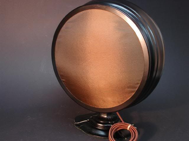

Directly below is an RCA100.
Original color, which I managed to match here, was a LOW gloss black. Although the grillcloth retention ring looks to be a bronze color - that's just a photo effect - it's the same low gloss black.

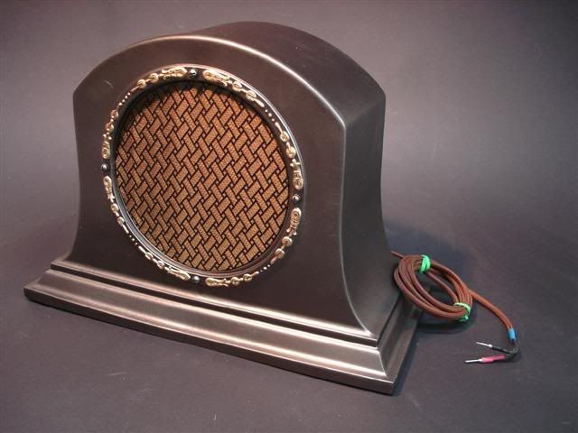

Next is a Canadian version of the 100A - same as the U.S. RCA100A speaker, just a different Canadian model number.
The 100A's were a low gloss dark bronze color. The floral relief around the speaker grillcloth retainer ring is gold in color.

Yes Doug, you are correct - I should have been more clear in mu statement.
The 100a (the round speaker case) does not have the pot metal voice-coil retainer. It has a machined retainer as shown here:
On the other hand the Bronze colored 100 speaker has the troublesome pot metal voice-coil retainer as shown here:

3/3/2009 7:46:47 AMDennis Wess
Mr. Berg,
As far as I was able to tell at the time that I worked on this speaker, it still had what was left of the original paint on it.......and, that was a low gloss black. It is possible I would think, that perhaps some were sold with the bronze color you speak of....but I cannot corroborate that.
Here's a couple of photos I took after disassembling the speaker, but before I stripped the old finish off in preparation for repainting.
I don't have a photo of it, but the I remember the original color as being in well-preserved state at the bottom of the speaker where the pedestal base attaches to the drum.
