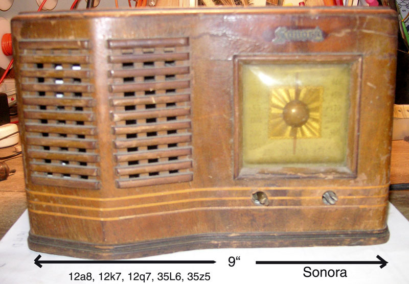

I was looking for the right thing to replace the inlay in this Sonora KM-450 above... and I decided to experiment a bit.
At first after removing the old loose inlay... I used some Elmer's white glue to try to fill in the grooves with. I wanted to try mixing it with food coloring and it worked. But the only color I had on hand was dark blue. So I tried that and filled the grooves halfway up with this mix. When it dried it looked more like black filler. I really wanted to try to get a brighter color.
So...yesterday I went out to buy more food coloring to mix a new batch in dark red or maybe yellow or even an orange to get close to the original look.
While in the craft dept. of the supermarket I saw these Metallic Paint colored glue pens. ( they have them with glitter too but the metallics are kinda like pearl-looking and not so cheesy )
Elmer's 3D washable paint pens:
http://www.orientaltrading.com/ui/browse/processRequest.do?requestURI=processProductsCatalog&categoryId=377320&BP=2110&cm_mmc=GoogleBase-_-datafeed-_-datafeed-_-datafeed&sku=73/53859&ci_src=14110944&ci_sku=73/53859
I tried a little of the GOLD on paper and it looks like a nice gold-pearl.
Now yesterday I had removed all the old lacquer and steel wooled the surface nicely. It is all solid wood.. like maybe black-walnut or something.
So I then used Watco Teak oil on it and rubbed it out after 1/2 hour.
Next day it looked gorgeous! I was even considering just waxing it and calling it done. But I wanted to get the inlay area brighter.
The surface had a nice smooth.. almost waxy feel to it from the dry Teak oil.
I figured that the surface was now less porous and so if I smeared the paint pens outside the grooves I may have less problems getting the dried excess paint-pen coloring off... and I was right.
So I tried carefully to squeeze it into all 3 grooves around the base of this Sonora.
I got it nice in some areas and messy in others.. and used wet fingers to try to remove excess.
I decided not to worry about excess and decided to scrape or sand off any excess after it dried.
I did exactly that and I like the results. It has a shimmery imperfect look that looks a bit like a gold pearl-like inlay or something.
Okay.. It's done now... Here's the finished radio.
It shows how I've used the (metallic-gold colored) Elmer's 3D paint pen to fill the grooves where the broken old orange plastic inlay was.
I'm pleased with the brightness of the gold.
After squeezing it into the grooves, I let it dry then scraped and sanded off any smeared excess areas.
It dries similar to the white glue.
Then I sprayed clear gloss lacquer over everything and a final wax coat.
Now all I need is to find the right knobs for it or something close even...lol
If you guys have them to sell...let me know please. (set screw or split shaft grooved)
