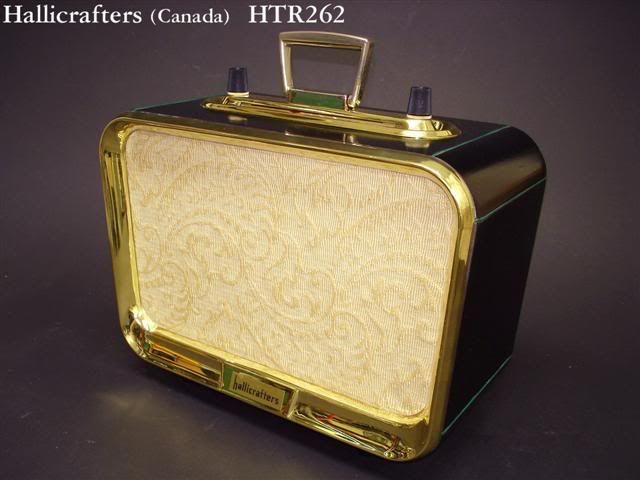

10/21/2008 12:10:12 AMDennis Wess
Simple but effective procedure:
- Use a backdrop
- Use a tripod
- Use the "time exposure" function to eliminate blur
- do not use a flash.....use any sort of flood lighting instead.
Here's a set-up:
Here's a couple of samples taken using the same set-up:
