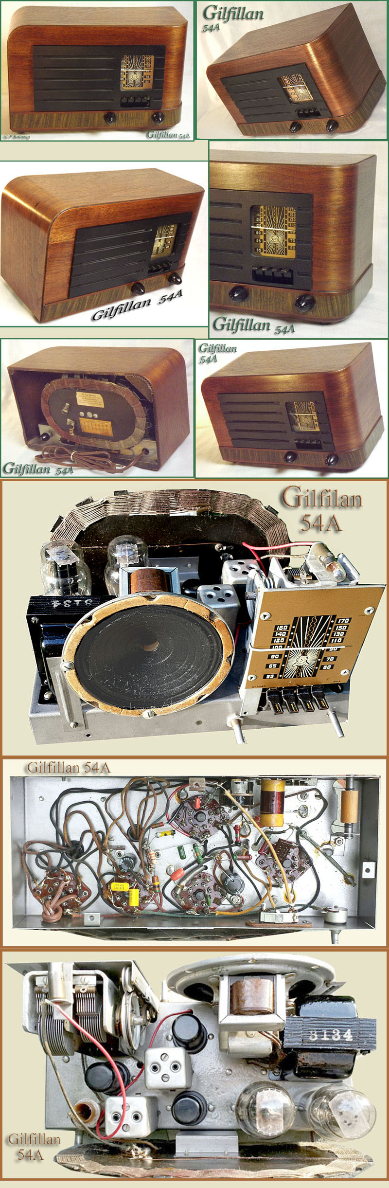

Here's a darn-right solid and rather beautiful ole' Gilfillan model 54A that I started restoring years ago.. and finally finished up this week.
Along the way I misplaced the knobs and had to re-order some.
Now, of course, the original knobs will show up for sure... lol
I completely re-did the entire chassis and got everything working perfectly. Then I gave it all a coat of lacquer everywhere to prevent any future rusting.
I really didn't have to do too much to the cabinet... as someone before me seems to have already redone it very very nicely.. (or maybe it was original?)Not sure.
It didn't have any kind of a top-coat though ...and so I decided that all I would do is give it a few coats of hand rubbed Boston Paste Wax and buff it up.
Well.. I think that's all it needed and it came out looking beautiful.
Sometimes the completed project makes you feel good by just looking at it. Of course, listening to it is a great part of that too.
All... Very rewarding kind of work!
Here it is:

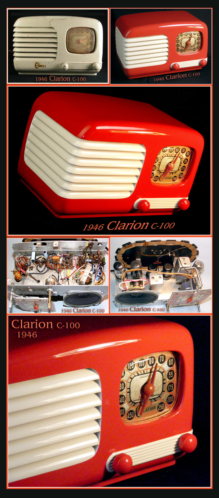

Gee I almost forgot that I sent all those images to Steve years ago for the http://www.radioattic.com/ web site.
So I was just browsing around there and I see on the upper left a little Clarion 100 that was all beat up and dirty.
What I eventually did with that one was to have a friend (an automobile/motorcycle painter) re-paint that Cabinet red & white for me, while I was rebuilding the chassis.
I eventually sold it to a fellow in Australia who bought is as a gift for his wife's birthday.
It's kind of hard to believe the difference before and after.
But here it is:
