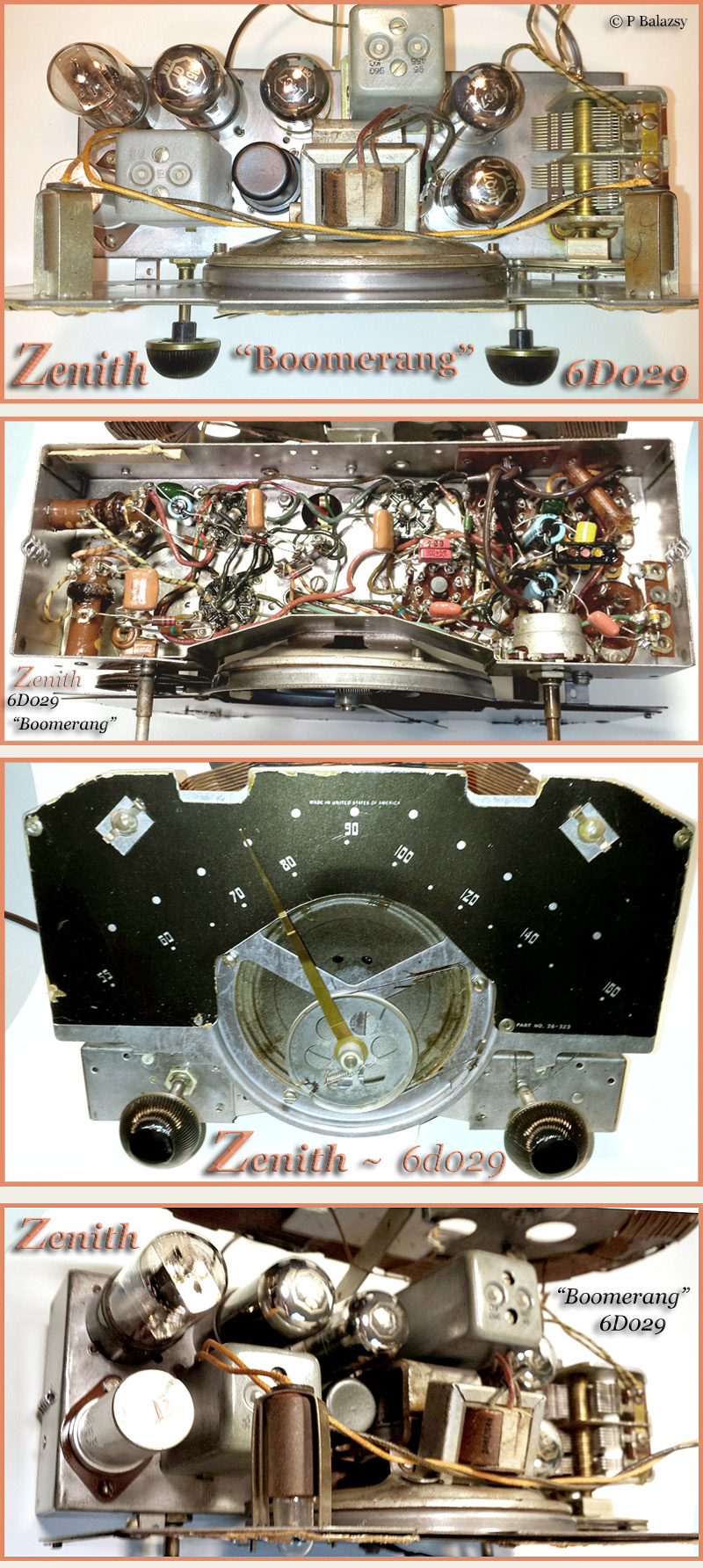

In the mean time I spent a few hours cleaning up the old metal chassis and neatening up the component placements and making everything look nice.
Here's the results of that effort:

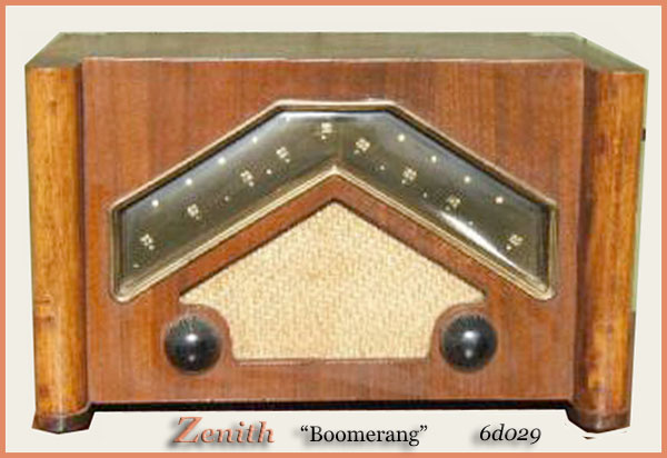

8/13/2014 4:38:27 AMZenith cabinet completed
Alright!
Here's the results of last night's effort to rub it out and put a coat of paste wax on it as well.
I had to replace the soiled old grille cloth and luckily I had a piece of metalic-gold upholstery fabric that just fit the bill.
I cleaned up the old discolored dial cover too by soaking it in 50/50 bleach and water. I then polished it on both sides with Brasso and rinsed it off with Windex and finally a little spray cleaner wax.
I think it's very acceptable now, and a lot easier than trying to make a new one.
The brass-colored metal trim around the dial was pitted so I cleaned that up and repainted it with gold spray paint and when dry I coated it with Wipe-on-Poly.
The knobs also got some new life with a good cleaning and a protective coat of lacquer.
Here it is:
