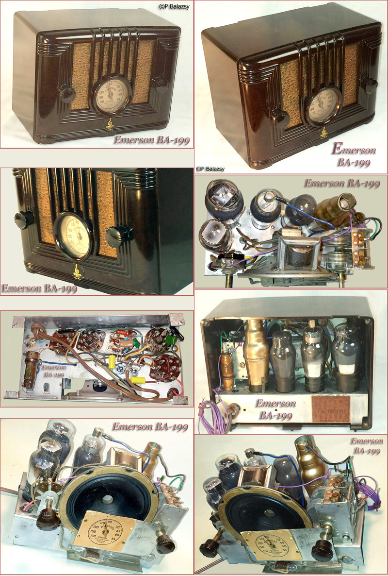

Here's another EMERSON radio that I picked up years ago, back in 2005, when I didn't know much about what radios to buy and what to look for.
So when it showed up I just gave it a fast play test and put it on the shelf never even removing the cabinet to see what was under the hood.
So this week I dug this "little TRF treasure" out and opened it up.
I discovered it wasn't looking too well underneath to say the least!
Everything seemed to be just "hanging by a thread" as far as wires and components from previous repairs. All parts were poorly soldered and hanging out in the air and only tacked onto the old leads with sloppy solder.
What a mess.
The chassis too was pretty discolored and rusted and all the wires were frayed and loose.
I can't believe I never bothered to examine this thing back in 2005. Guess I was just trusting that the guy who sold it to me on Ebay knew what he was doing and.. I blindly trusted it.
Y'know ... I'll bet there are a whole lot of innocent buyers out there, even today, who buy something for the nostalgic value and may not know anything about electronics... Right?
Anyway.. I completely re-worked the whole under-chassis circuit (as well as rewiring the top) of course too.
Then, as for the rusted chassis, I used wire brushes and Emory cloth to clean off all the chassis rust.
When it was nice and shiny I sealed everything with lacquer, both top and bottom.
After aligning it I then started on the Bakelite cabinet.
I didn't have to do too much because it was in excellent condition as far as no cracks or dullness.
So I simply cleaned it up very well, and then buffed it with a clean soft buffing cloth.
Then it was looking so beautiful I decided to seal it with a coat of Mohawk clear lacquer.
When dry I waxed it with Boston paste wax.
Now it looks better than new!
Here it is:
8/6/2014 7:51:32 PMTerry F
Outstanding!
8/6/2014 9:55:37 PMJohn K
:Outstanding!
"Better than new" is a lofty goal. Well done.
8/6/2014 11:34:36 PMPeter G Balazsy
Thank you.
It's always a lot more work than we anticipate. Isn't it?
But it's well worth the effort in the end when it comes out looking nice.
8/7/2014 8:32:59 AMSteve Davis
:Thank you.
:It's always a lot more work than we anticipate. Isn't it?
:But it's well worth the effort in the end when it comes out looking nice.
Peter, as always, it is fantastic!
