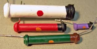

I tell you whuts . . . . .I would have to think back veeeeeewy-veeeeeewy haaaaaaaard, to even remember a carbon composition of that 5 watt power rating category and its consequential physical sizing requirement.
The typical cut off is 2 watts, as is shown in this display of 1/10 on up to 2 watt physical sizing of carbon composition resistors:
However, some of the old "dog bone" and "glow-bar" mechanical configurations may have approached those possibilities:
Then too . . . . you may just have read the parts list and carrried forward with that /its specified aspect.
If you can come back with the set and its model, we could evaluate its functional usage and see if a much more desirable 5 or 7 watt wirewound or metal film resistor could be used.
( Since that resistance is not being a common 50-75 ohm matching impedance for power RF work and need for non inductive characteristics, I do not perceive of that carbon composition aspects requirement .)

I'm with Edd. Modern 5-W resistors would be classified as power resistors - typically wire wound or metal oxide, not carbon composition. Here is a source for 150-ohm, 5-W power resistors: http://www.radiodaze.com/product/12404.aspx
Actually, carbon-comp resistors are sort of out of fashion for virtually all values and ratings.
