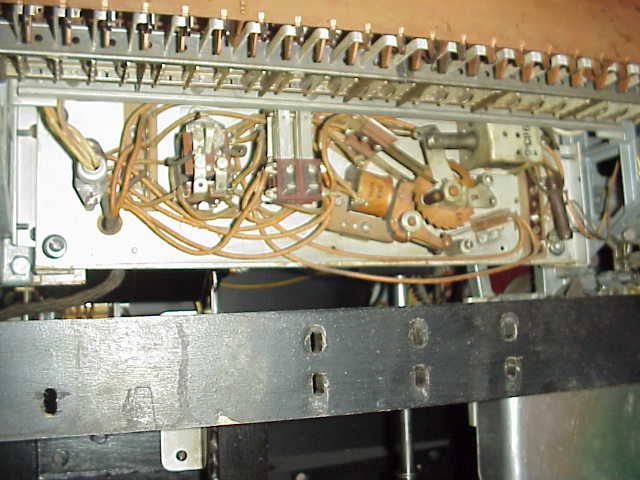

Now, I don't know just how much you know about "Fertilizer" jukes, and possibly your BEING familiar only with the audio amp, phono cartridge and the units sound aspects.
Heres a quick cumulative rundown from the time right until the nickel ( 5-10-25 cent piece) hits the slot . . . . 'cause youse . . . . " got to get something that's really hot."
Initially the coin chute dumps into the coin selector mechanism where it precisely evaluates coins for their weight, thickness, magnetic susceptibility and a final overall diameter check, to then channel into one of 3 final thin chutes to roll down to, and finally brush across one of three leaf switches to do a solenoid activation of a latching relay.

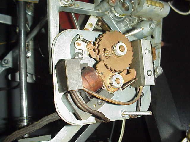

(See the two "Fertilizer" photos below of the round "Sawtooth" discs, specific to that design of latching relay.)
That type of relay is functioning as the mechanical "credit memory" for the coins that were inserted. A nickel ratchets the relay one step, a dime, twice, and a solid quahtah ratchets it 5 steps.
As record selections are punched off, the relay backsteps sawteeth until all of that previous changes "credit" is used up.

You will recognize the selector unit by its huge number of coils . . . . one for each record position.Then use a bright light to find the involved pins "in-out" positions / conditions.
On a " Seeburger ", of which I am 1000% more familiar with, you can merely use your fingers to mechanically reposition pins to either their Activated (pulled) /or / Deactivated positions.
Once you get all of the "Fertilizer's" " pins " to their deactivated positions, with no playing then, you play yourself one song and investigate
why and if the pin is not deactivated at the end of that song.

"Fertilizer" electro/mechanics photos :
