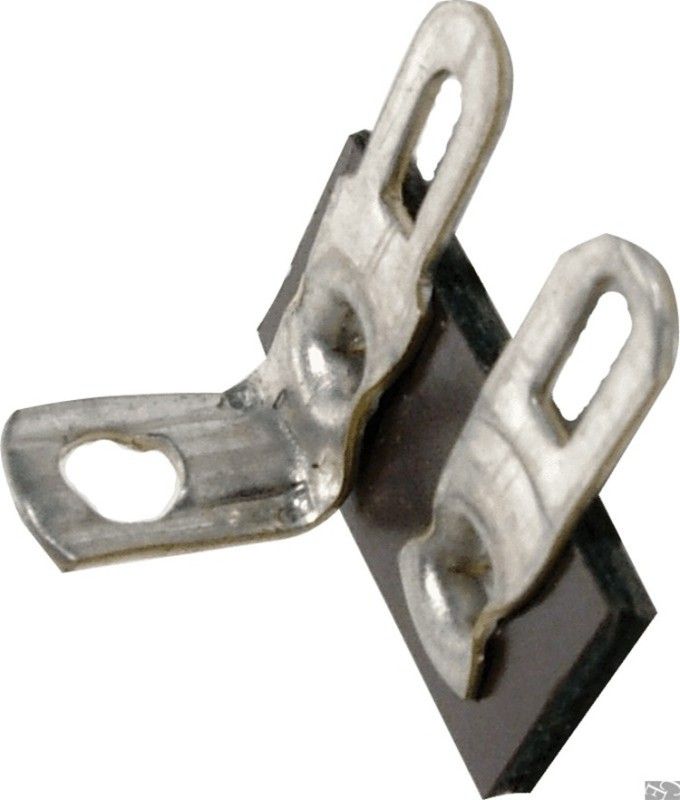

Hmmm....maybe it would be a good idea to provide a good secure anchor point for those wires.
A simple 2 lug termstrip mounted to the chassis (screw or solder) would do so. Just be sure to not tie any connections into the grounded lug.....unless they are supposed to go to chassis ground.

I agree with the "lug" idea but due to the age of the attached components I didnt want to stress things again by rerouting them.
